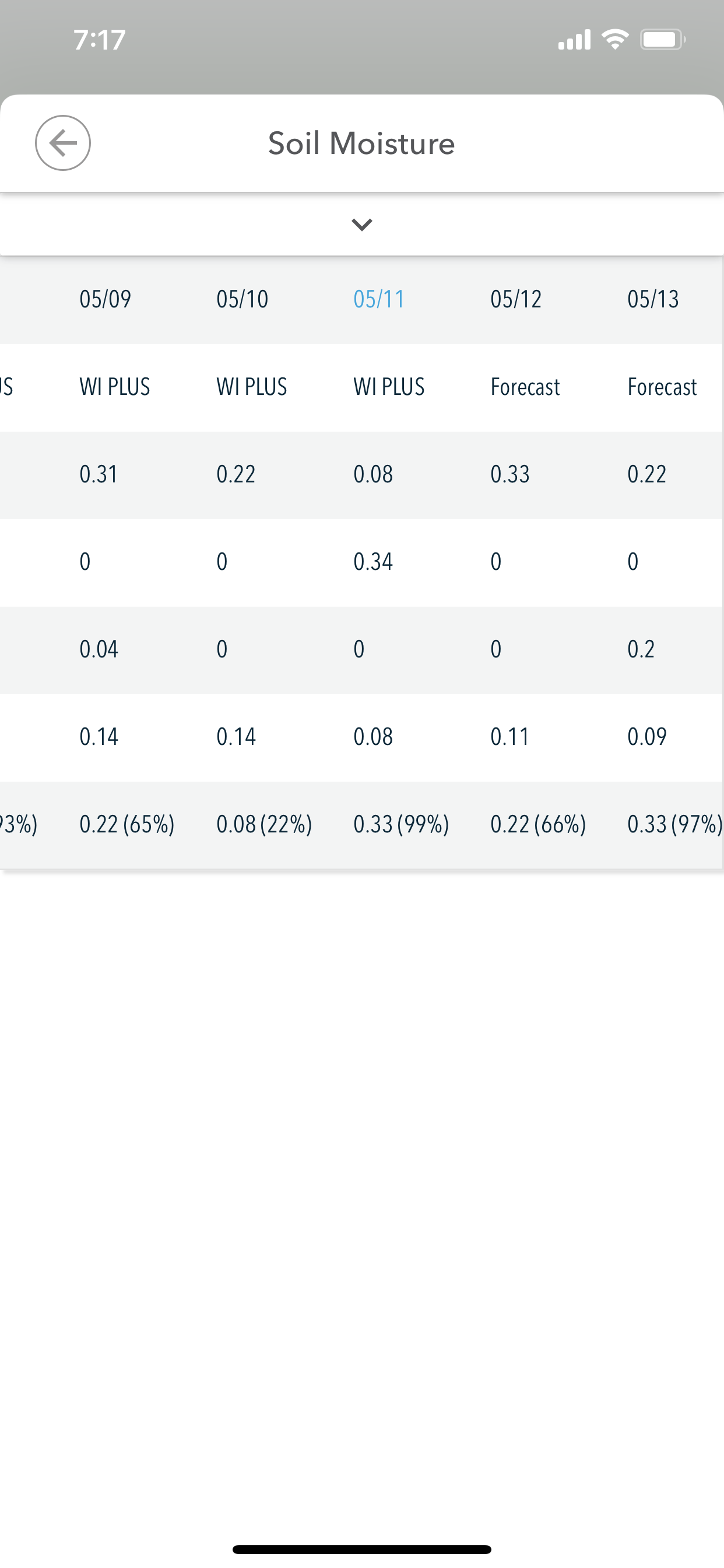

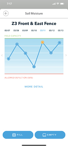

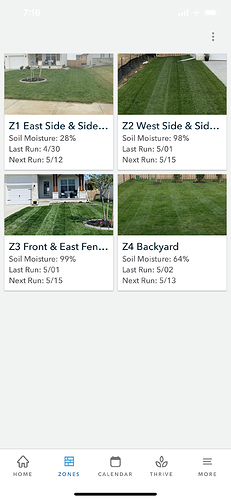

This morning, three of my zones (2-4) ran.
The soil moisture levels reflect that:

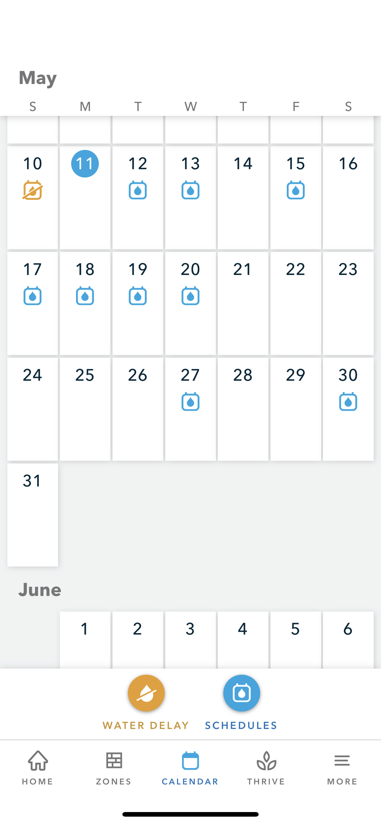

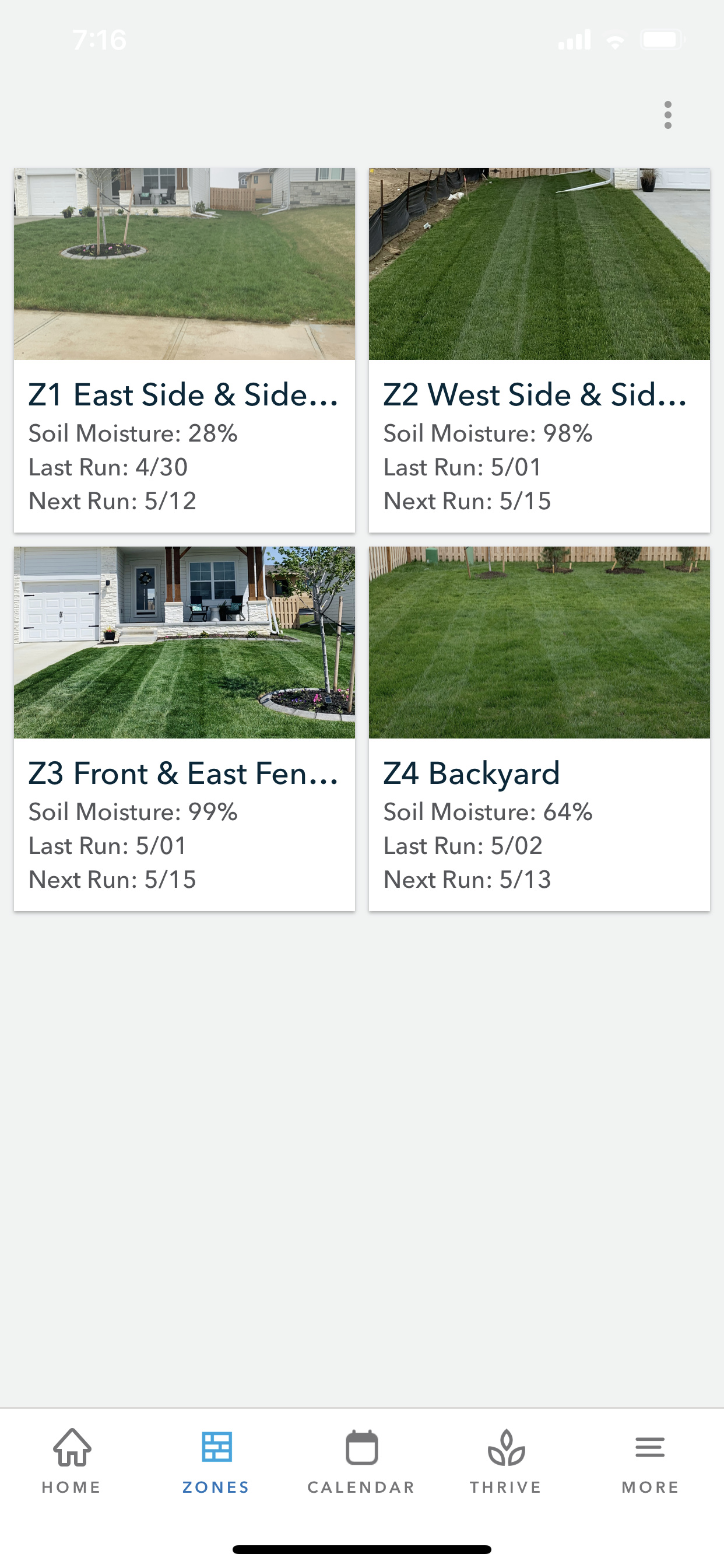

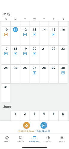

But my calendar and Last Run don’t:
I refreshed and reloaded the app :man_shrugging:t3: Is this a common glitch?

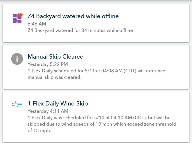

In your case the zones were actually running when the controller was offline.
Screenshot%20from%202020-05-11%2007-37-11
Since they reported data when offline that explains why you are not seeing the zone run on the calendar. This actually did expose two defects.
  • We were correctly reporting the zone run data in the moisture graph but in your instance we should have shown that zones 2 and 3 watered offline. We are just showing that zone 4 reported watering offline. This issue has been fixed.
  • The offline watering events not showing up on the calendar is also a defect. I will have the team review and fix this. It’s an edge case (typically the controllers are online when watering) but something we should correct.
Thanks for reporting this display issue!
