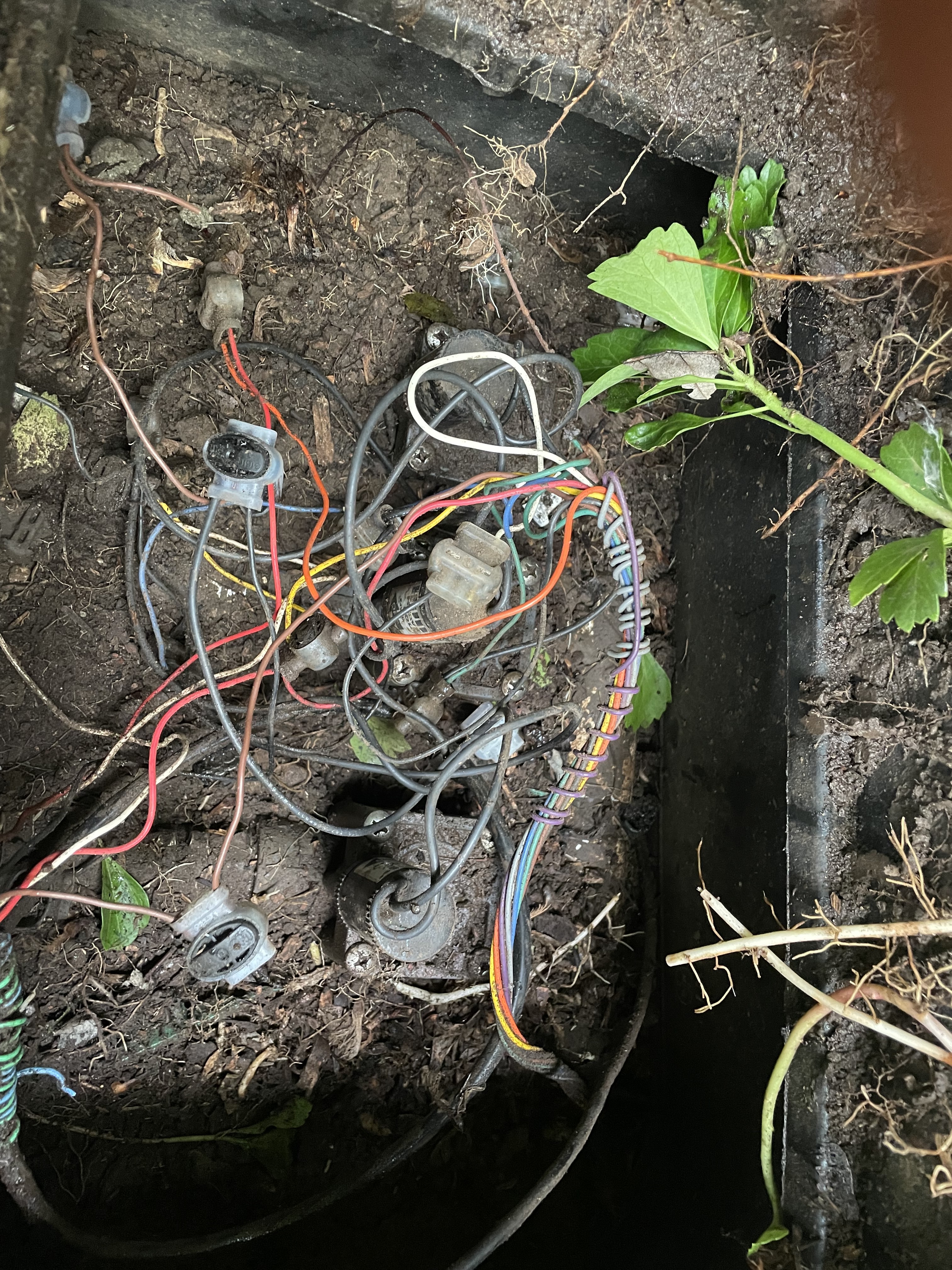

This is what is inside the first box. They don’t know where the second box is yet but said there should be one. But some thing in this box got zone 4 working temporarily. Any insight on the incompatibility with Rachio and all systems? My sprinkler guy seems to really not want to work with it. I’m going to call another place today.
As long as the system was 24VAC, we should not see any compatibility issues. If it was, for example, 24VDC, we would likely see different symptoms. It looks like you have quite a few wires in that box. Sprinkler valves, especially the solenoid, can go out over time too. Also, wires can break as well. I neighbor was having issues recently and I found somewhere between the controller and valve, wires got touching. At the valve end, insulation was cracking as well.
Thank you. Do you envision there is a second box after seeing this picture?
Seems likely, I cannot tell, but maybe all the wires come to this box and then go to another
all fixed, found 2nd box, was a cut wire issue.
