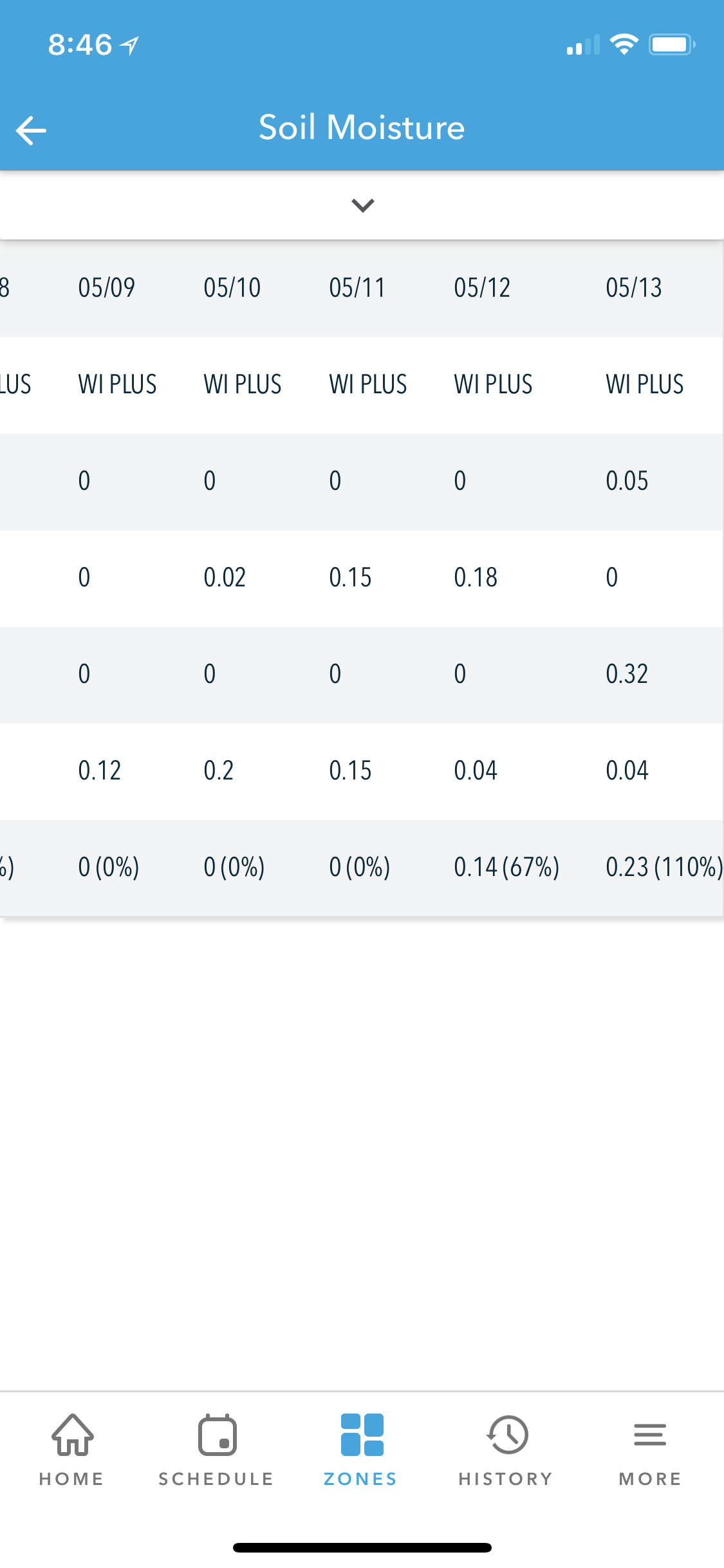

Do I have something wrong in my configuration? Yesterday we had .58in and today .23 and will continue raining and the controller already scheduled irrigation for tomorrow.
The soil moisture is already in 109%. I’m using Weather Intelligence +.

Currently we check flex daily schedules at the 12 hour and 1 hour mark before the schedule is supposed to run. Your soil moisture graph correctly reflects the precipitation received today and your zones arent scheduled to run again for quite some time since they are at 100% soil moisture.
At the 12 hour check (I think 4PM) your calendar will be rebuilt. We are working on a more dynamic solution where the moisture graph always reflects the calendar. Sorry for the confusion.

This is why flex daily is so fun. Based on predicted precipitation you are not watering until 5/23.
