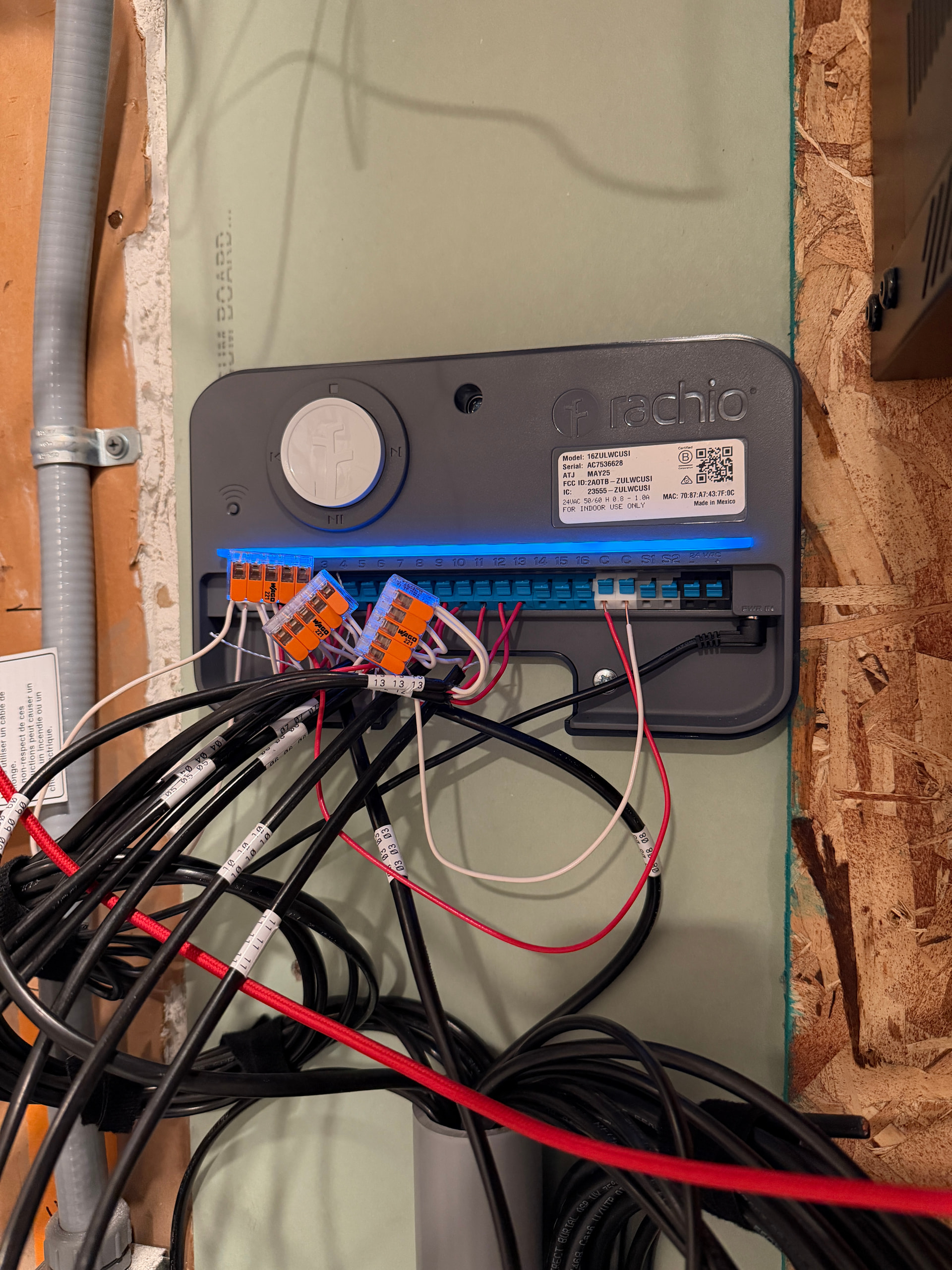

Right now, I have each common terminal coming into a 5 port wago connector, and one of the wires from the sprinkler valve connected. The other wire is then connected to each zone. I understand this is an odd setup and not normal, so what I am wondering is if in my setup I need to use the same common wire on each sprinkler valve? Typically this wouldn’t matter in a 24vac setup, but this isn’t a typical install.
Picture of the current wiring/controller installation.

I don’t think individual common wires and the connecting them together should be a problem. The picture doesn’t show where the red wire in the right Common terminal goes, nor the left Common and Master Valve terminals.
