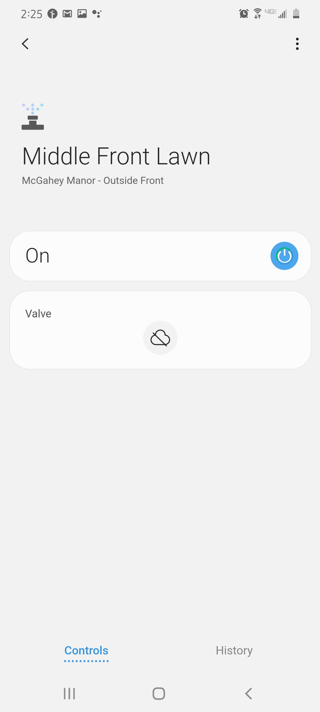

I pressed the power button in ST and it triggered a 10 minute quick run. Stopped it, ran it again, and on the second stop attempt I got a network error in ST…
Just created an automation when I turn on my front porch lights (zwave switch), to turn on Rachio “middle grass zone”. By the time I opened my front door the zone kicked on for a 10 minute quick run.
I added it to the garage (previously “outside”) and the zones show up as controllable devices now!
I don’t know if there’s some kind of hiccup with the Sonos integration, or if it was magical to assign the Rachio to a different room the second time, or what… But it works now, so there’s that!
