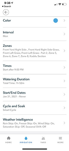

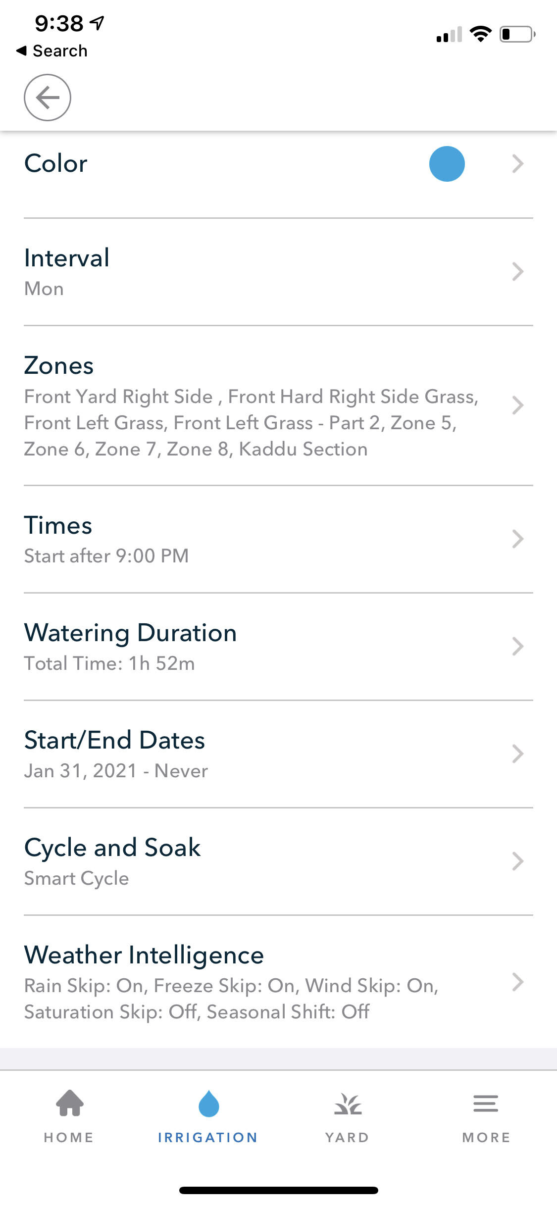

Thanks for responding! I have a fixed schedule. For the rest of the settings here is screenshot
It looks like you are only watering on Mondays. Is that correct? And watering at 9 pm. Are you sure it isn’t watering then?

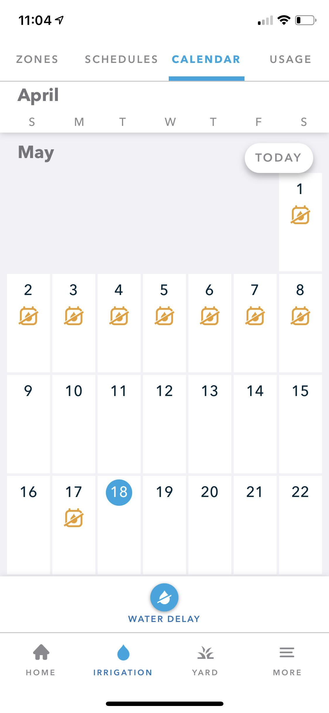

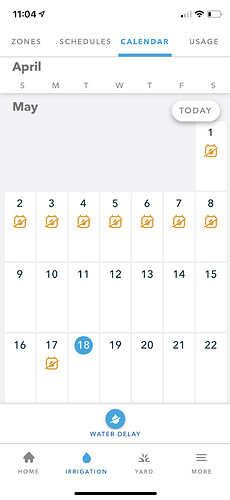

It is set to Monday and it skipped all the time. It was cold and rain frequently till recently so I didn’t realize that it was skipping days when it was supposed to actually run it. I had created temporary schedules that run only when I select “Quick Run”. Look at the calendar to see it never ran (but skipped on those days when mattered)
If you select the 3rd or 17th, what does it say for why it skipped? If it was rainy or windy, then it won’t water on those days, but waits until the next scheduled day to water. If it’s once again rainy or windy on that day, it will skip again.
