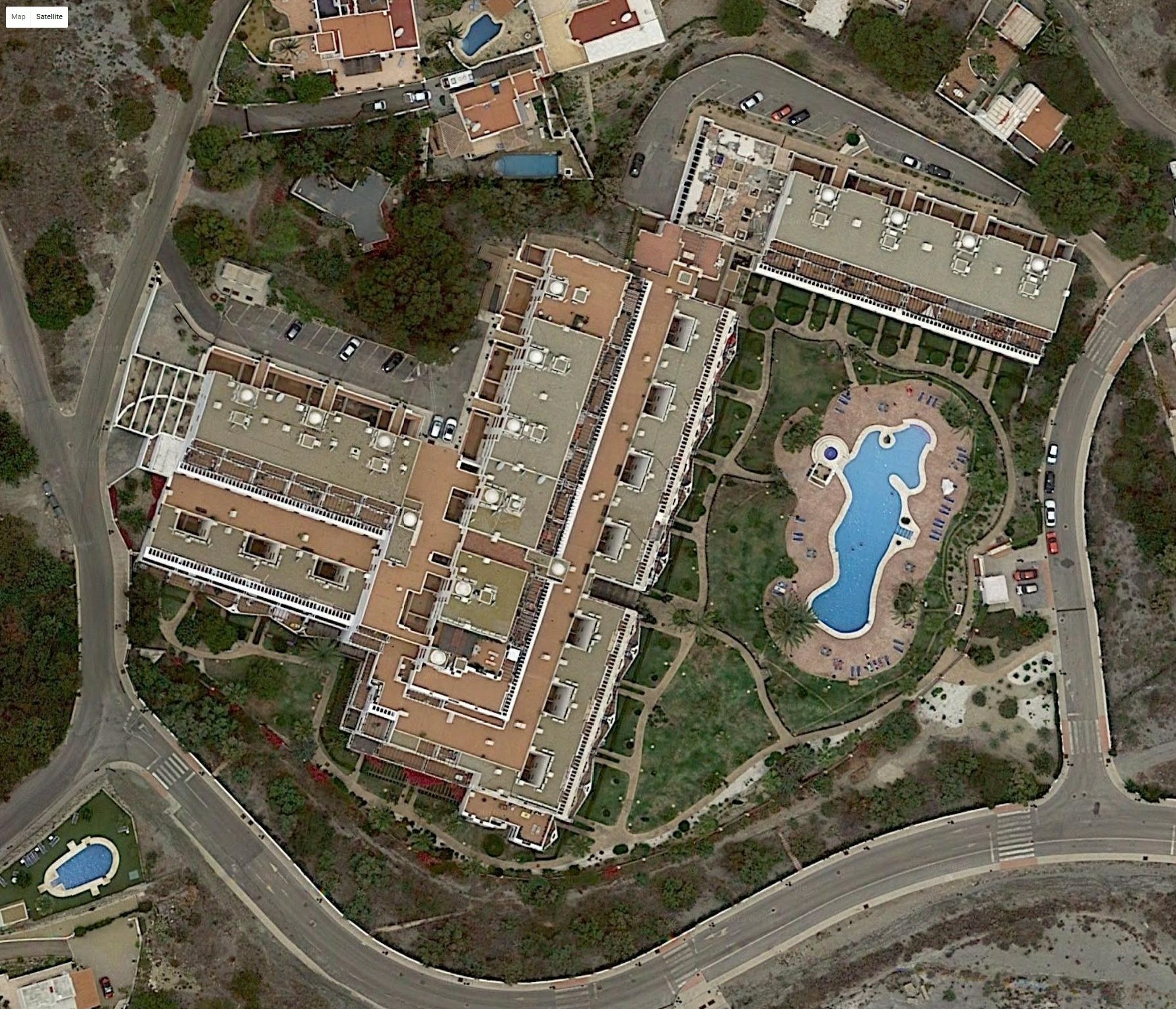

View towards the south - so the hill to the back right throws the gardens near the road (bottom left of the overhead pic) into shadow during the winter months
