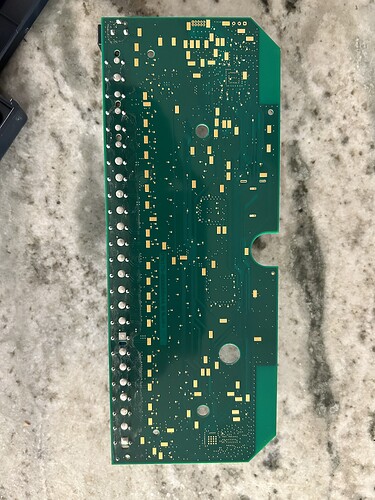

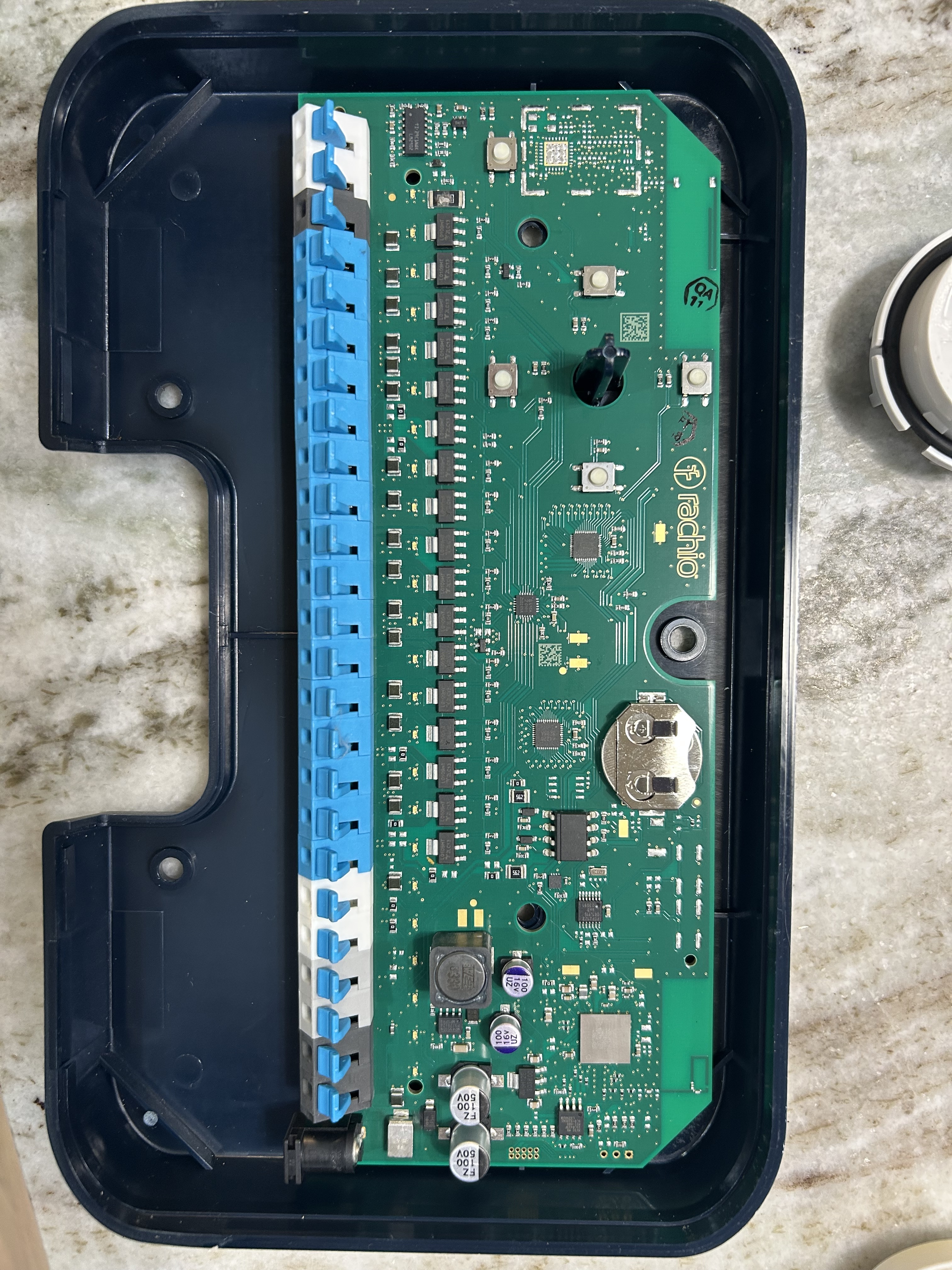

Hello. Lightning struck a nearby tree on my neighbor’s property and my Rachio 3rd generation stopped working. Won’t power on. Then I put in my old Rachio 2nd generation and then lightning stuck a tree on my property and now that one won’t power on. This is a picture of my 3rd generation. Is there anyway to fix it?
@ldavila - I think I see the problem item, the top item on the row of what I think are power transistors. It will require desoldering the old component and resoldering a new component in place.
@Gene - any idea what that component is?

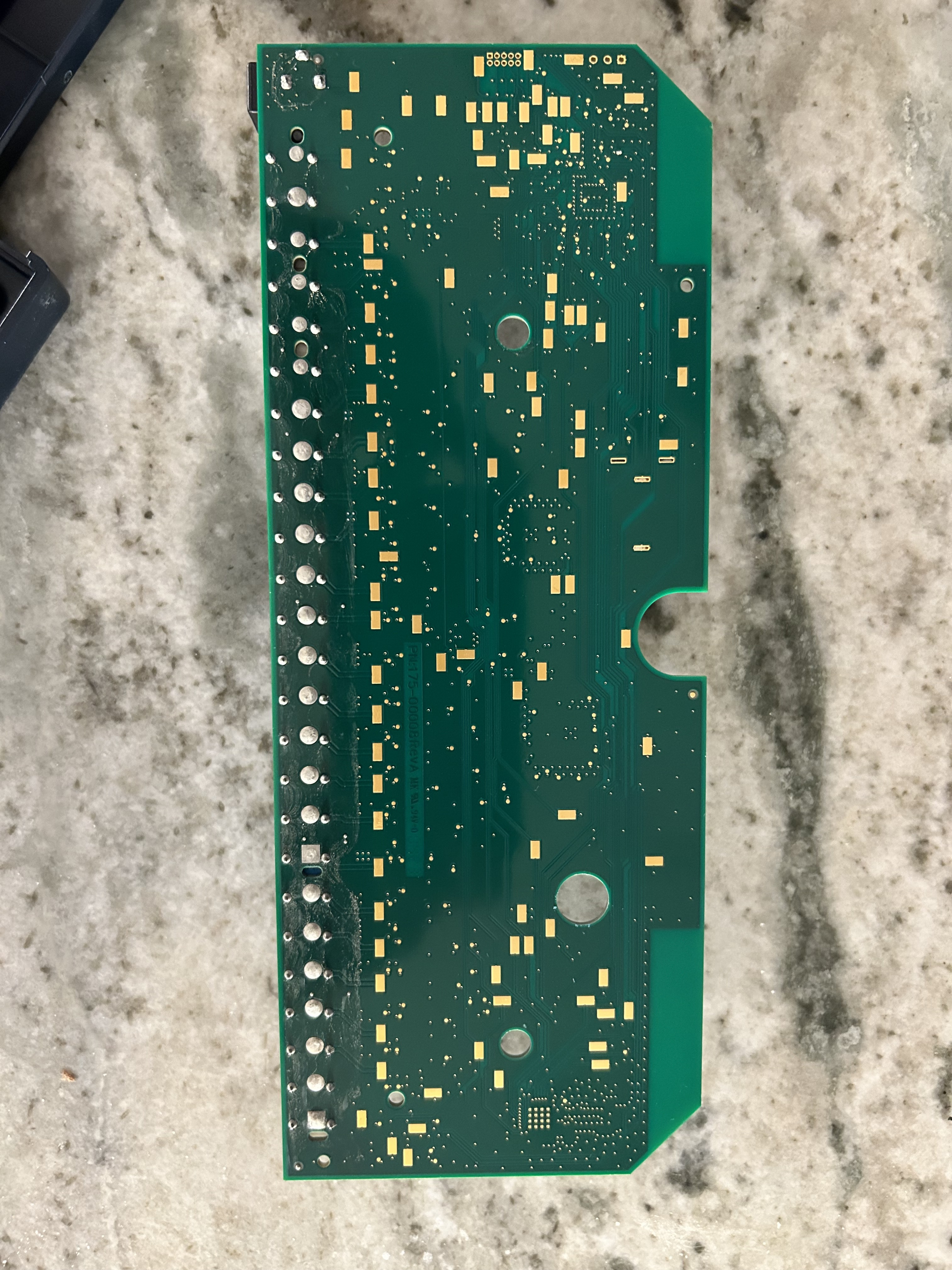

It seems okay on the back
