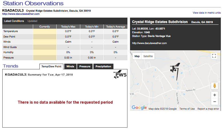

Looks like this station has stopped reporting to pwsweather in early 2017. Any data you were actually using appears to have been transferred via CWOP system instead (Rachio can read these).
Data within the CWOP (here) appears to be intact and they are registered as an active NOAA station list here (link, search for “D3642”). On the surface everything is in place for you to continue using the data without needing to switch the station.
