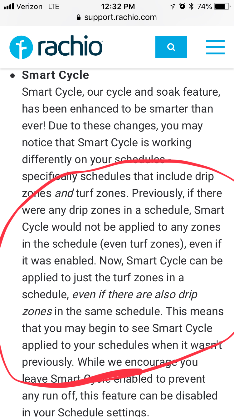

Cycle/soak has never worked with drip zones. It’s been pretty well documented.
Sorry for the confusion. @Linn is correct drip zones do not cycle soak. Here is more information.

Mainly, drip zones typically run for hours, and by adding cycles they could go for days. You could “cheat” by using a different nozzle type
Agreed.
At some point in V3 development this was supposed to get in, at some point I hope to provide a more clear warning.

In the link franz provided about smart cycle, there’s talk of clay heavy soils and the need to cycle/soak these zones to prevent runoff. (Which is exactly what I’m dealing with here). It even goes so far as to say that “experts agree” that 30 minutes seems to be the optimal soak time between cycles. It seems that a 30 minute soak time would perhaps add a couple hours to a zone that is receiving a deep soaking at best. Surely not days. (Of course I can imagine someone watering for 10 minutes and then soaking for 30 minutes for a total of like 3 hours of actual water time could result in some super long times. But, wouldn’t that zone benefit from a resize of the physical drip nozzles to something smaller?)
