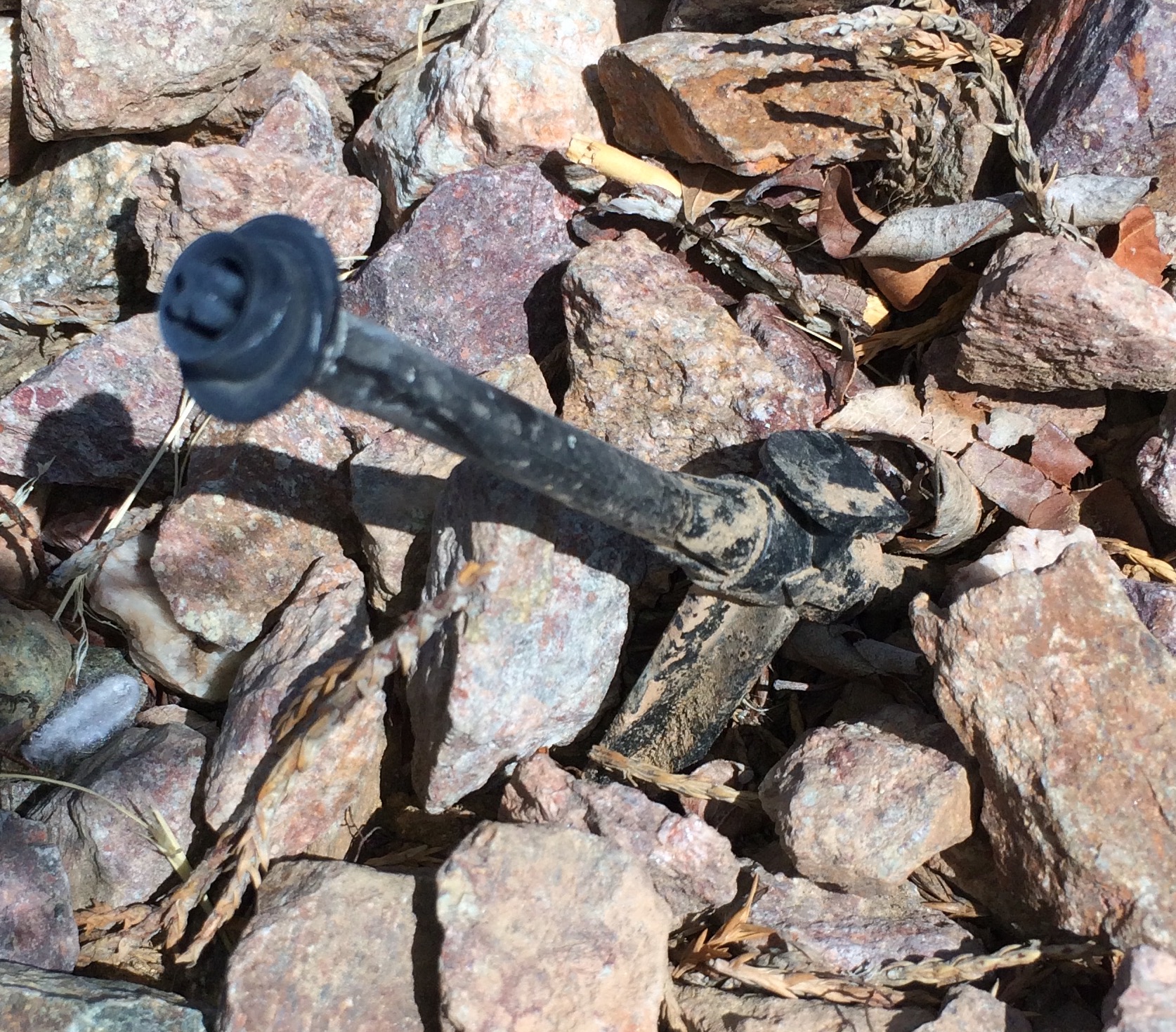

@Az_Rael, any chance you could post a photo of your bubblers and/or the make/model? Since they are the adjustable type, I bet the precip rate on them is 2-3x what the default is in the app. Adjustable bubblers have some of the highest outputs of all nozzle types.

Will see what I can do tomorrow. It will have to be a photo of them, I have no idea what brand the landscapers installed when we had them put in.
@emil I have two different bubbler styles. See photos at the following links:

From your photos, the top photo (the one with the screw) is a bubbler. Pending how much you have them adjusted, the precip rate will vary. The lower photo is actually an emitter. Are these nozzles on the same zone?

Ah, I didn’t know the difference. They are not in the same zone.
